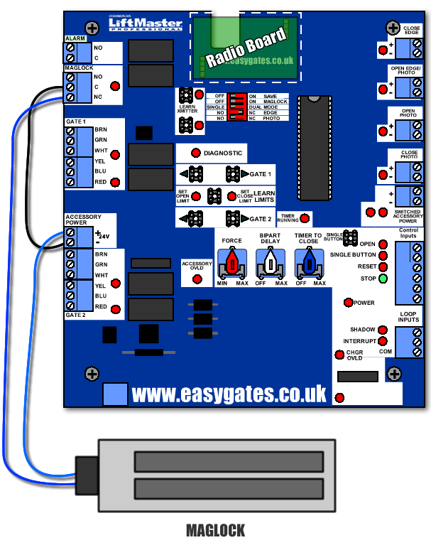

1. Wiring a Maglock to the CB24V

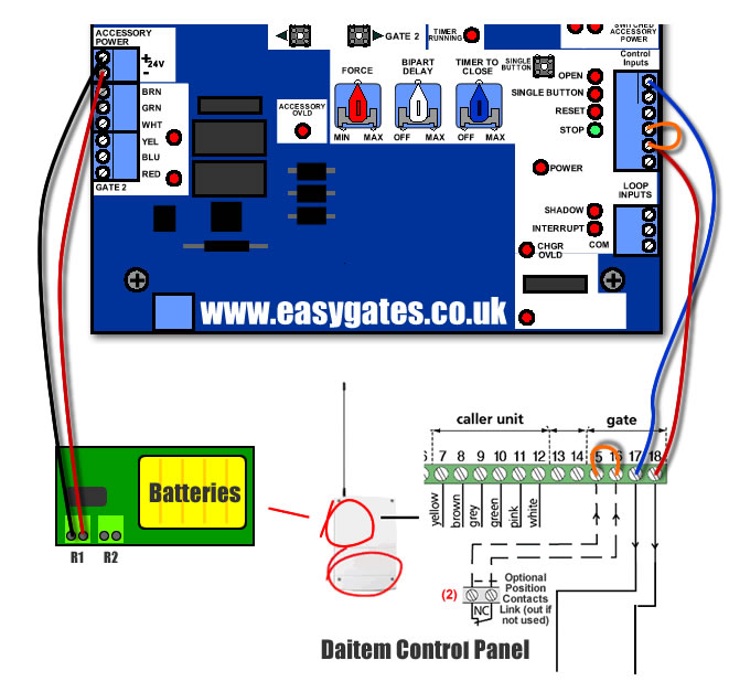

2. Wiring a Daitem Intercom into the CB24

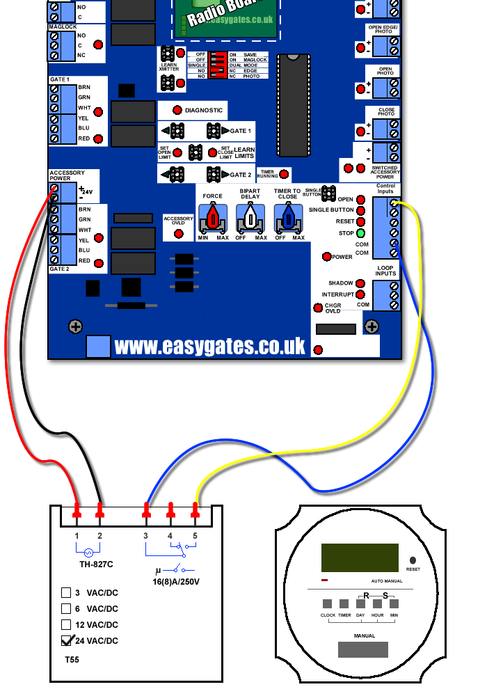

3. Wiring a 24V Time Clock into the CB24

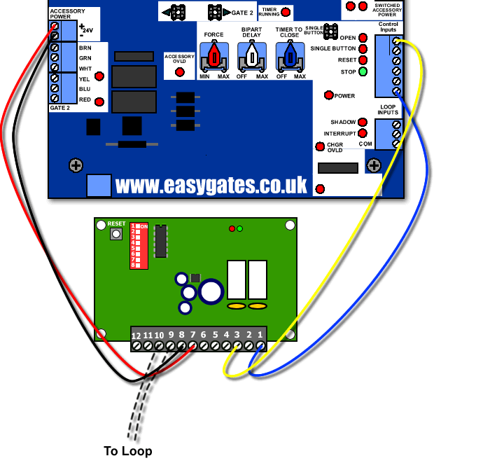

4. Wiring a Loop Detector into the CB24
