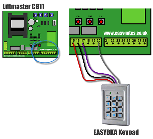

1. Wiring the EASYBKA Keypad to the CB11 Control Panel
Attached Files Image(s)

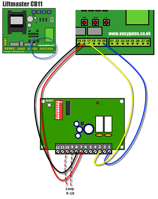

2. Wiring a Loop Detector to the CB11 Control Panel
