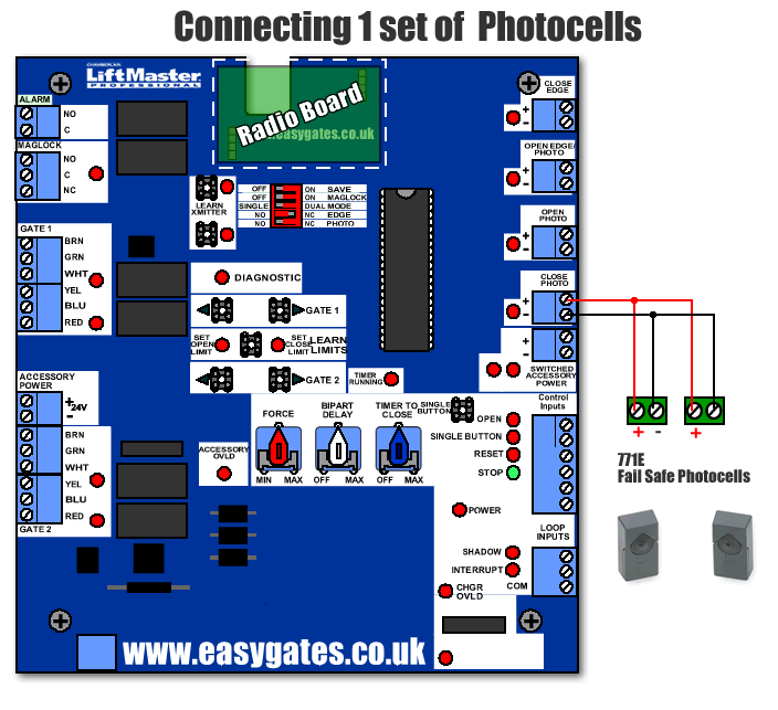

Hello,
Can anyone advise me of the correct wiring for a single set of photocells as supplied in the kit to the CB24 board?
Jeremy
Reply
#2
Hi, i have drawn this diagram up for you. Please let me know if you require more information. Make sure you link out 'Open Photo'
Attached Files Image(s)
