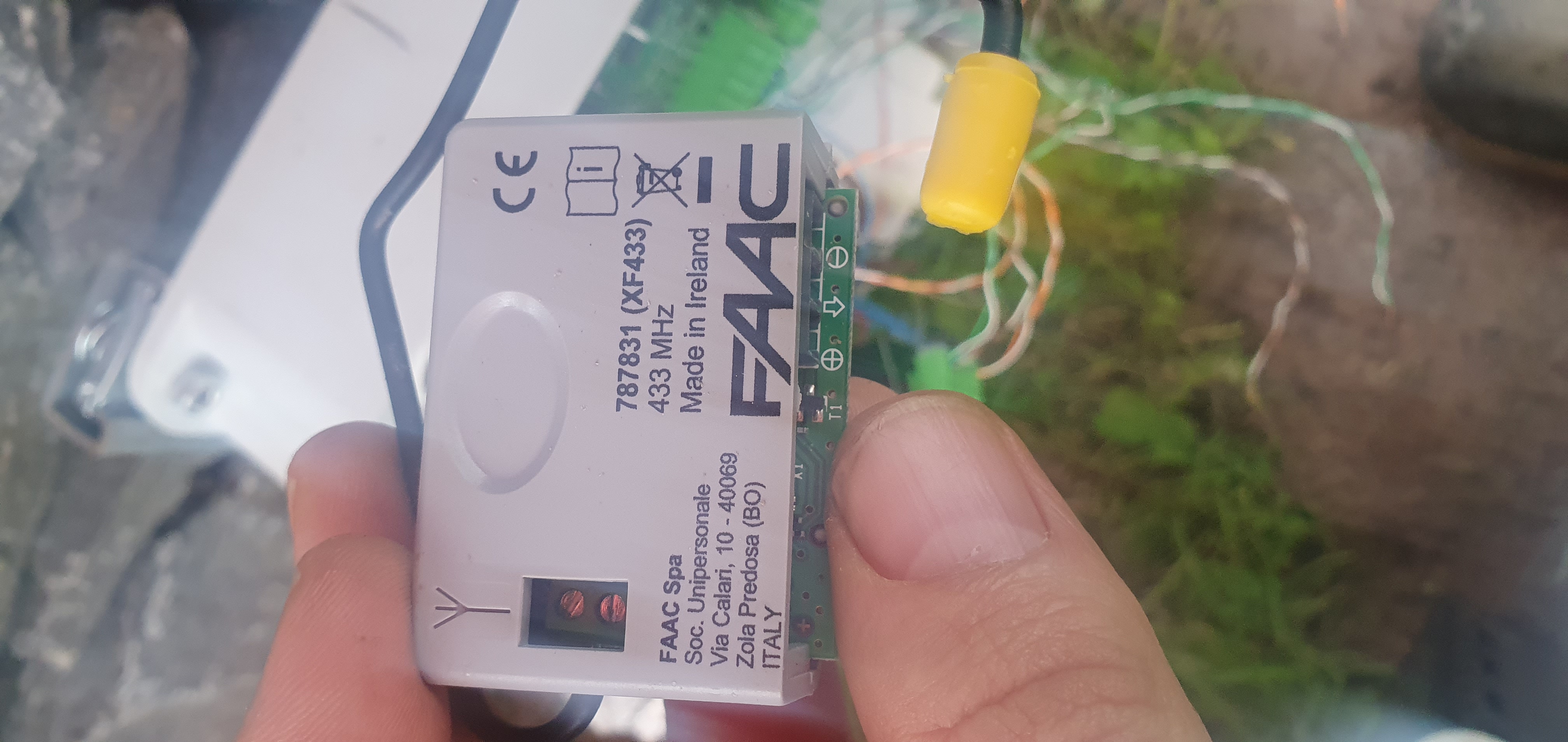

Hi I am installing an xf868 receiver to my 455d control panel but I am wondering is this quick connect as cables come loose when I connect up to power supply manually when pushed in. The receiver is 3 connectors but panel at quick connect is 5, ant help here would be great.

Hi I contacted the seller and I have been informed I got the wrong part by mistake so awaiting replacement. Hopefully this resolves the issue.

(30-10-2021, 07:50 PM)Decyep wrong type, need the other plug on board, that is is used on 24v boards Wrote:

(29-10-2021, 02:20 PM)Dec Wrote: Hi I am installing an xf868 receiver to my 455d control panel but I am wondering is this quick connect as cables come loose when I connect up to power supply manually when pushed in. The receiver is 3 connectors but panel at quick connect is 5, ant help here would be great.
Hi Dec,
Power will be wired into the receiver. You will then need to wire from the relay outputs to the push button/open input on the 455d panel. When the receiver is triggered, it will trigger the input, opening the gates.
-Jamie
