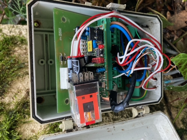

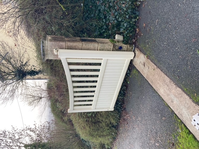

We gained some automatic gates when we moved into this house - it seems they were installed in 2007. The control box has recently gone up in flames!
As far as I can tell the manufacturer of the control box is no longer in business - it seems to be a PL24 from STOR'M, controlling 2 24v motors embedded in the verticals of 2 swing gates.
I'd like to find a replacement controller. Having looked over this excellent website, I am wondering if a BFT Thalia P would do the job?
If so what do I need? the controller and some suitable new remotes?
Any recommendations?
many thanks in advance
-NiCK

Hi,
Unfortunately, The THALIA P has its own ENCODER technology which only allows the use of 24v BFT control boards.
Please email technical@easygates.co.uk if you would be interested in a brand-new system.
