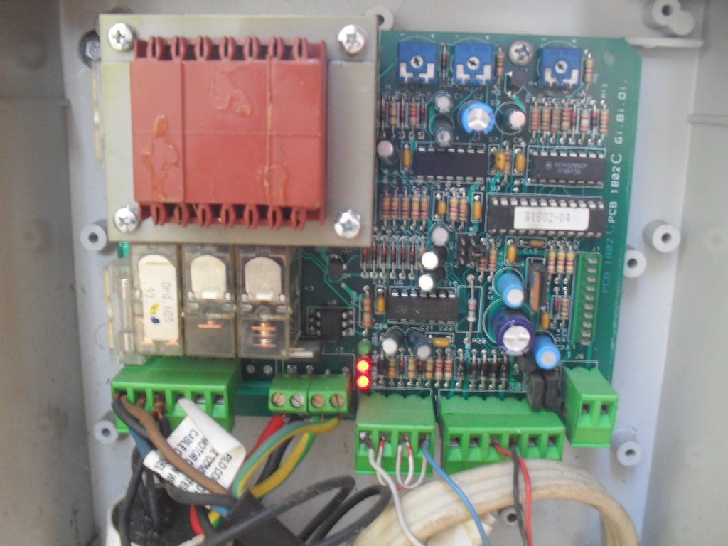

    Guys wonder if someone can help like to put in a wired switch
to operate gates, it is an old unit installed late 1990's looked
on net no luck on a wiring diagram . I assume it is just a 2 wire hook up cheers. Gibidi plus 2a?

Hi,
Hope you are well. If you wish to use a push button to operate this you will need to wire into 16 and 18. This is the N/O input, please see the manual below showing this.
https://files.uk2sitebuilder.com/94/09/9...76c4e7.pdf
(page 8/16 PDF).
Kind regards
-Jamie
