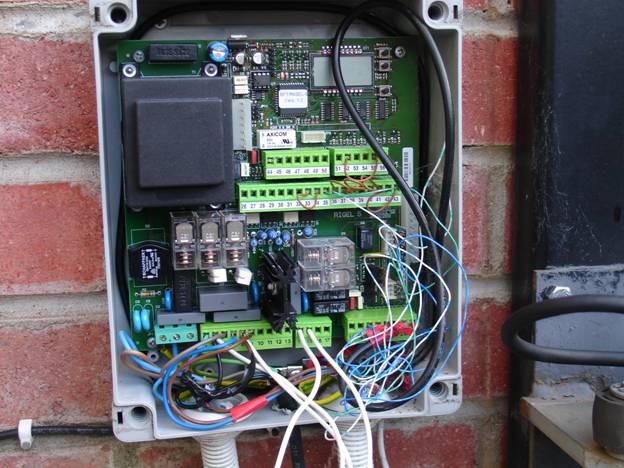

The gates swing, and are standard. Yes, they are controlled with two BFT hydraulic rams. Inside the control box is a PCB marked RIGEL 5, and two large plastic canisters dropped out (still connected) that look like retro fitted capacitors or suppressors of some sort.
Any clearer? Smile

Hi Buzby,
Sounds like you probably have the BFT hydraulic rams that only have locking in one direction or possibly not locking at all. Its risky fitting rams that lock in the closed direction if fitted to wooden gates because quite often the bypass valves will blow when a strong gust of wind catches the gate leaf!! Rendering the motor buggered!! your only feasible option is to fit a magnetic lock coupled with a drop bolt, that would keep both leafs securely locked shut.
if you look underneath the ram you should see an information sticker showing model numbers. if you can get that info, and the control panel you have is the best you can get BFT wise, the Rigel 5 will do everything you want and more!!

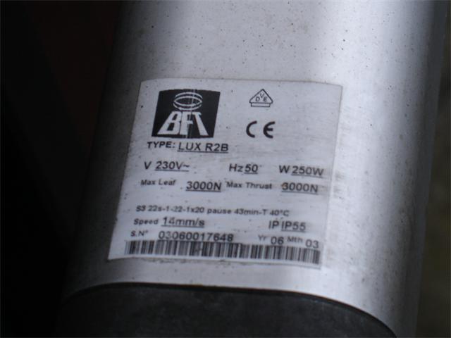

It's not both rams that have the problem, just the one, and it as done this since they were new (I was told) which was the reason I assumed there was simply a set-up issue.
Here's the label;

Hi Buzby,
The Lux r2b does have locking in the closing and opening cycles,
i reckon the internal valve has failed or at some point something/someone has hit/forced the gate and damaged the seal.
The ram can be repaired with a replacement valve which would be far cheaper then purchasing a new ram, i am sure a valve will set you back nothing more then £20, you would require someone with a mechanical/gate automation background to carry out the repair though and test the motor.
