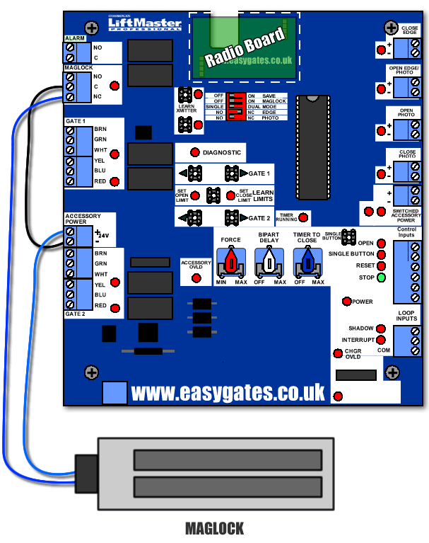

Fitted lyn400 24v works great but have problems wiring maglock GL-220. Tried various ways but either does not work at all or wont release when gate tries to open. Have toggled mag on etc and checked and double checked everything but must be missing something somewhere.

Hi Roy, Attached is a diagram on how to wire a Maglock into the CB24. The 2 wires coming out of the maglock on the diagram should be the power wires (0V & 24V) and your maglock button on the CB24 should be set to On.
Hope this helps
