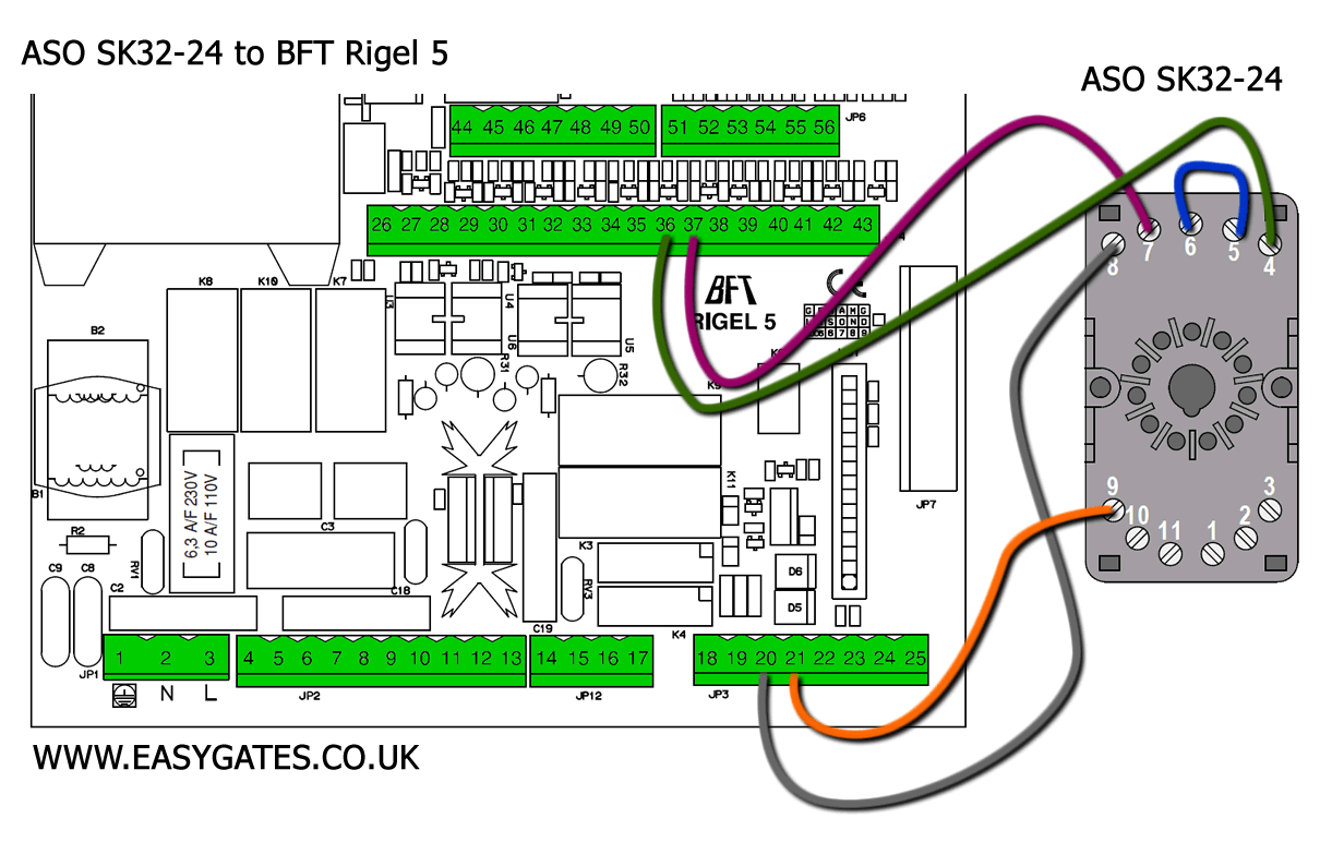

Simplified installation diagram for connecting the ASO Solutions SK32-24 to BFT Rigel 5 control panel.
