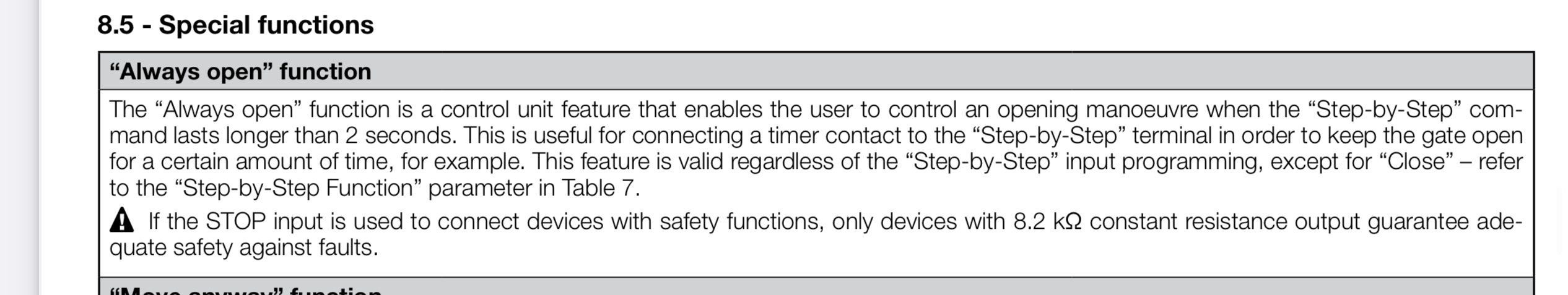

Hello
I have the same problem:
Currently what happens is that the gate attempts to close (when fully open) but it only moves the gate say 1m then it reopens. This is when I press the same button on my app which causes the gate to close.
Were you able to find a solution? I suspect it is due to the “always open” feature. Which i am not sure if it can be disabled
Attached Files Image(s)
